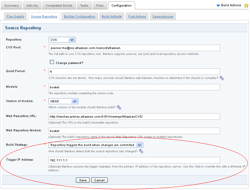

Step 2. Configure Bamboo to trigger a build on code check-in
  1. Click 'Home' to go to the Dashboard.
  2. Click the 'All Plans' tab.
  3. Locate the plan in the list and click this icon:
  4. The 'Configuration' tab will be displayed. Click the 'Source Repository' sub-tab.
  5. In the 'Build Strategy' field, select 'Repository triggers the build when changes are committed' (see screenshot below).
  6. This will display the 'Trigger IP Address' field. If you want Bamboo to receive post-commit notifications from the respository's primary IP address, leave the 'Trigger IP Address' field blank. If you want Bamboo to receive post-commit notifications from a different IP address, type the IP address in the 'Trigger IP Address' field.
  7. Click the 'Save' button.
Screenshot: 'Plan Configuration--Source Repository-Build Strategy: Repository triggers the build when changes are committed'
