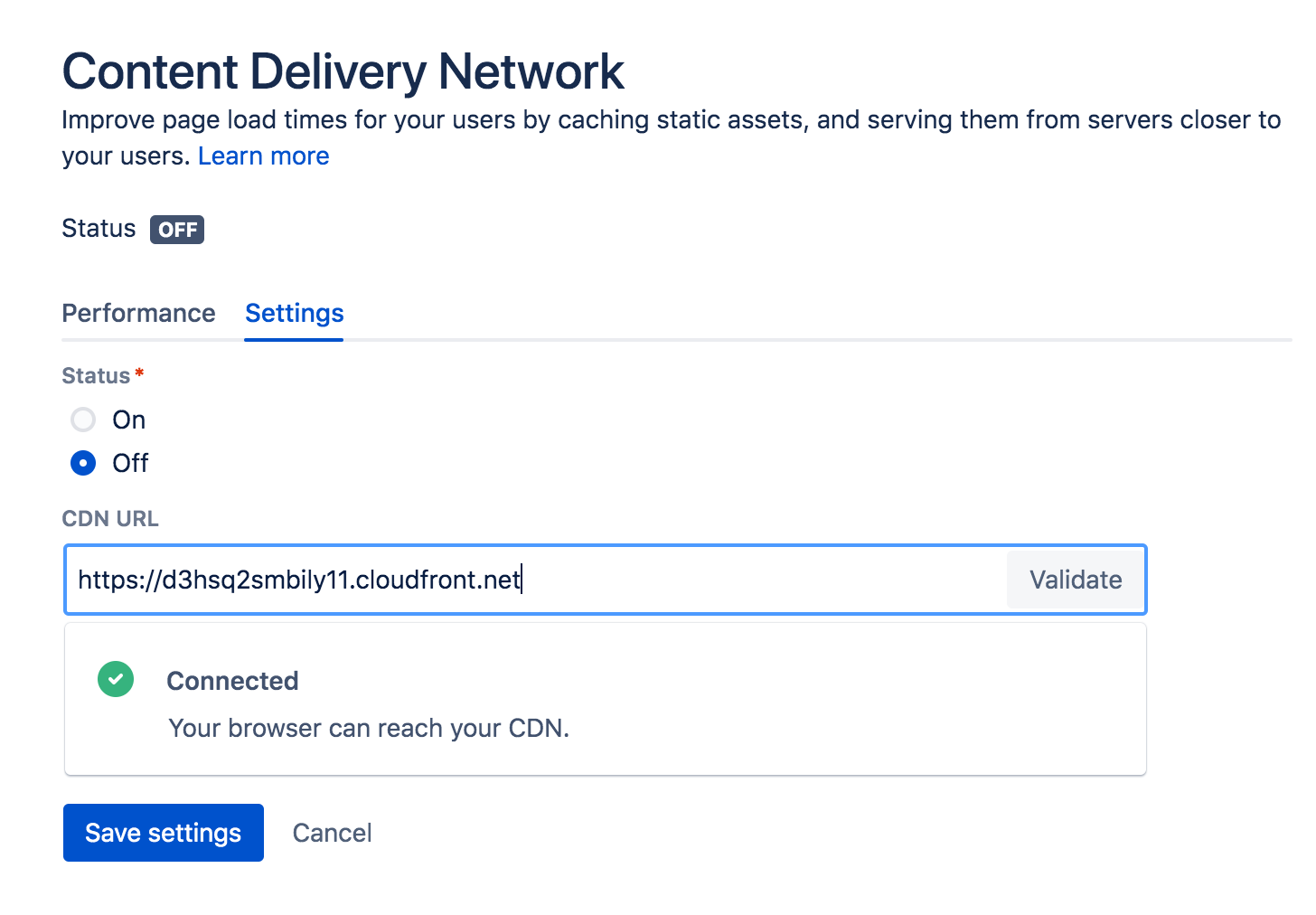

Enable CDN in Jira applications
Once you've configured your CDN, you can enable the CDN option in your Jira application.
To turn on CDN:
  1. From the top navigation bar select Administration  > System.
  2. Choose Content Delivery Network and navigate to the Settings tab.
  3. Set the status to On
  4. Paste the URL generated by your CDN into the URL field and hit Validate.
  5. If successful, save your changes.
