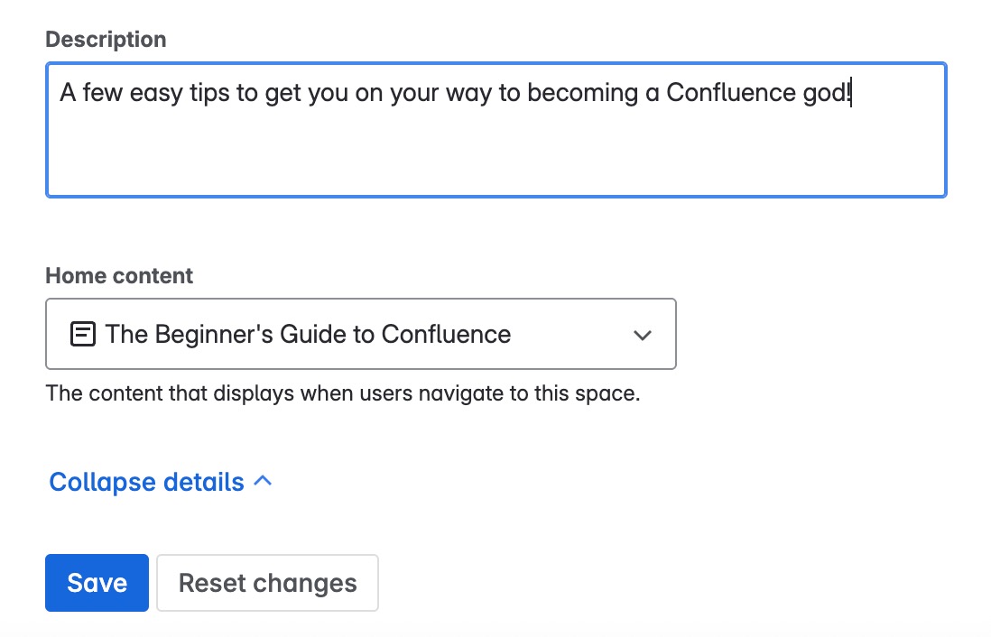

Set another page as your overview
You can set any page in a space as the overview.
To set an existing page as your overview:
  1. Go to the space in Confluence Cloud.
  2. Next to your space's name in the sidebar, select More actions (•••), then Space settings.
  3. Select Space details.
  4. Select More details.
  5. In the Home content field, use the dropdown or search box to find the content you’d like to use for your overview.
  6. Select Save.
To use a template to create a space overview (such as this Team homepage template from hubspot), you’ll need to create a new page from the template first, then publish to the space, and then set it as the space overview.
In space details, you can update a space's name, description, and status, or select a page in the space as the homepage.
