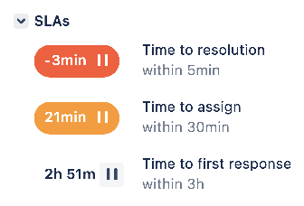

Paused
Agent view:
Customer view:
The SLA has been paused due to the conditions set or the time is not being counted as it is outside of working hours.
When the SLA is at risk or breached when paused, it will use the same colors and layout as shown in the above row, but the clock icon will change to a pause icon.
