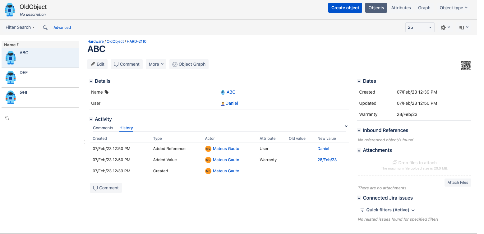

Before we can create and execute the automation rule, we need to make sure that the target object type has all of the attributes that the original object type has. For example, in the image below you can see that OldObject has the Warranty and User attributes (aside from the default ones):
So in the NewObject I'll also add the same attributes:
