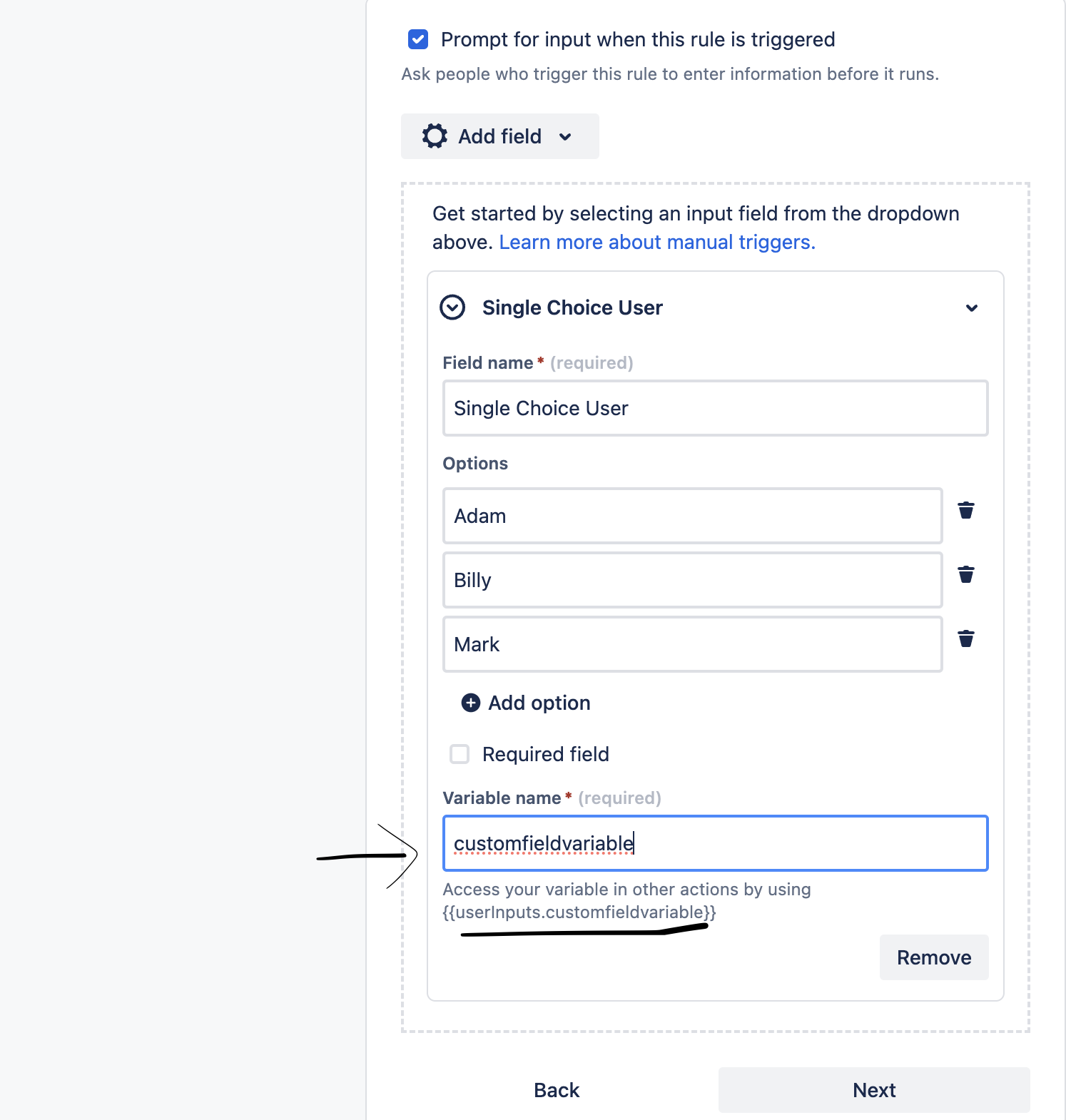

When selecting Dropdown (Single choice) in the Add field section, you will be prompted to fill the name of the custom field.
3. Please make sure to provide the same name as the custom field that is in use.

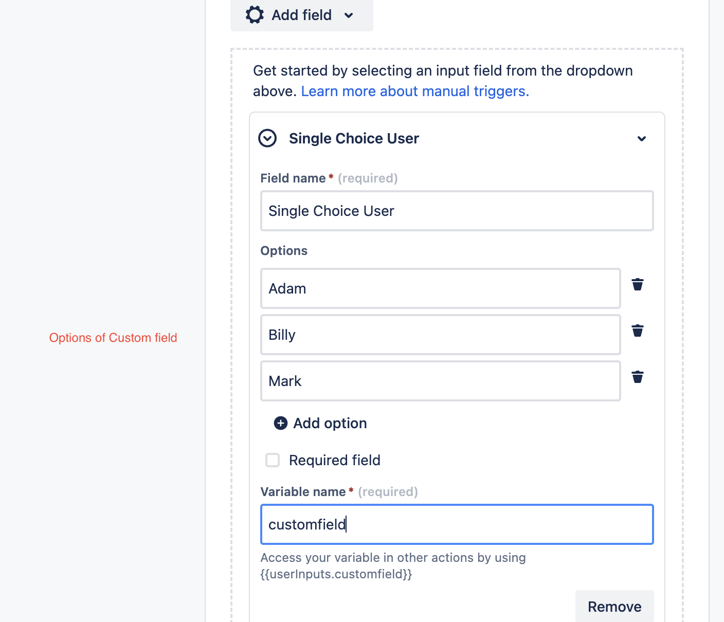

4. Make sure that the options of the custom field in the prompt action are same as the options in the actual custom field Single Choice User
5. Next,save the custom field as a Variable name. For eg, use customfieldvariable. which can be accessed by {{userInputs.customfieldvariable}}

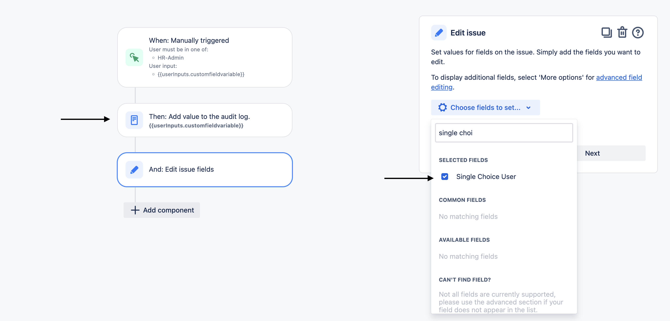

6. Add an Edit Issue action and select the Single Choice User field as shown below
7. Add a smart value to access the variable that was created before. Variable {{userInputs.customfieldvariable}}  will fetch the value at the time of User input's during the Prompt action.

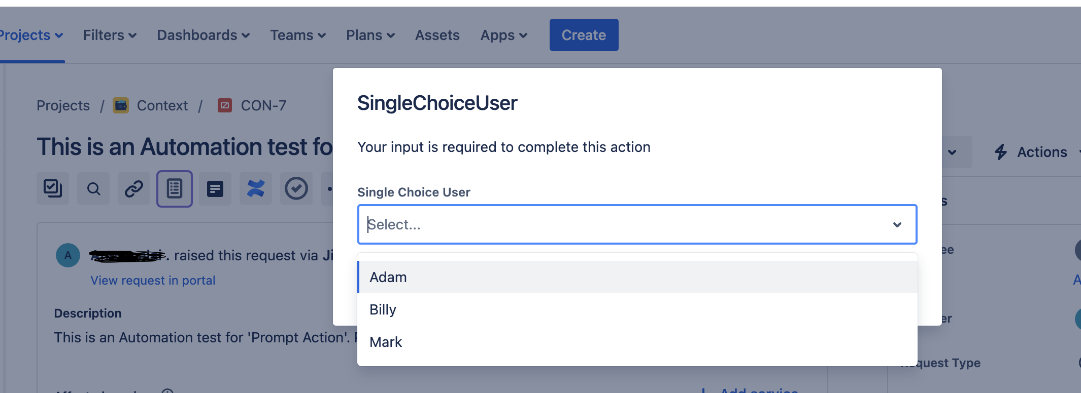

9. Create a test ticket and click on the Actions tab and click the Automation rule in question.
10.  Automation rule will now prompt for user Inputs. The options visible in the screen are same as the custom field.

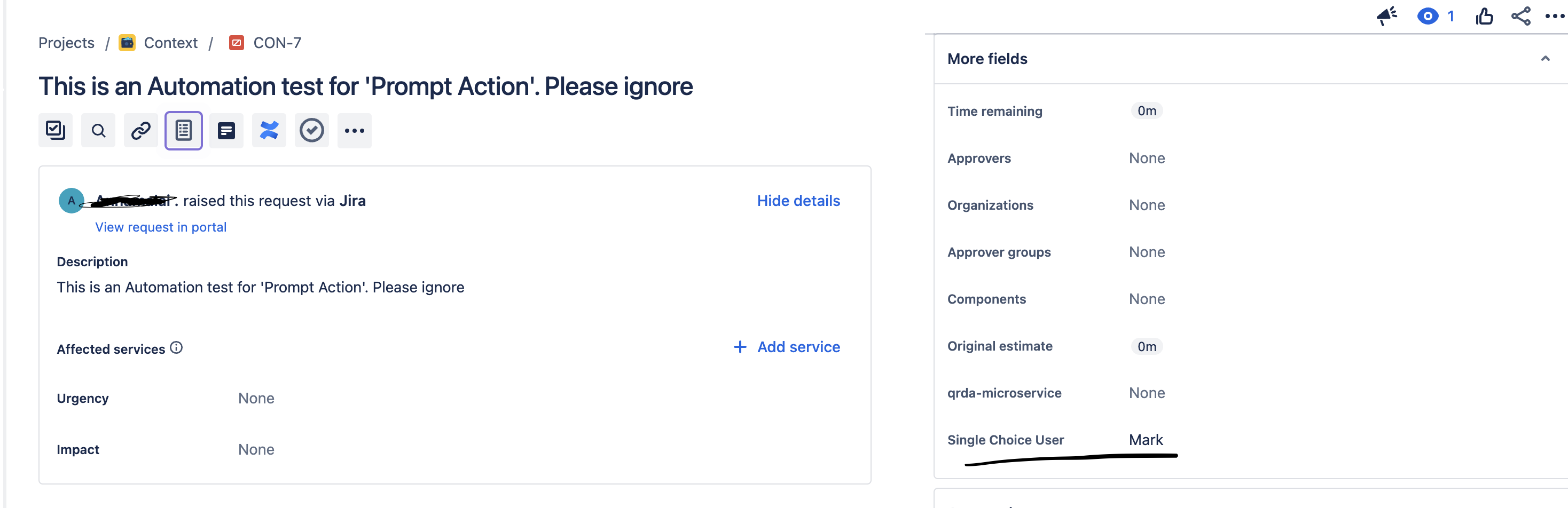

11. Automation rule will be executed and will update Jira's custom field with the value chosen.
