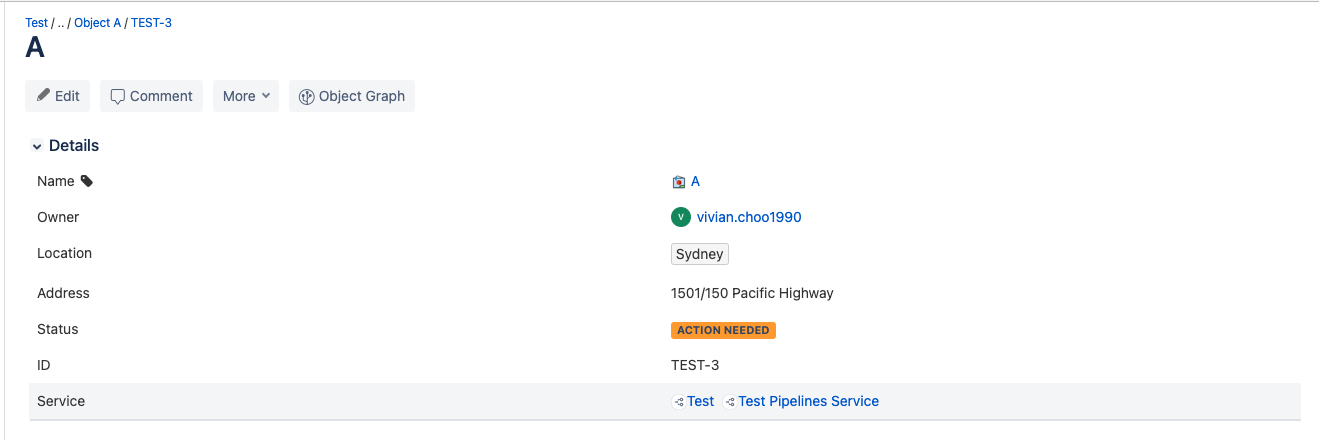

Based on a schema with object types and attributes below:
Objects under this object type will have services referenced to them:

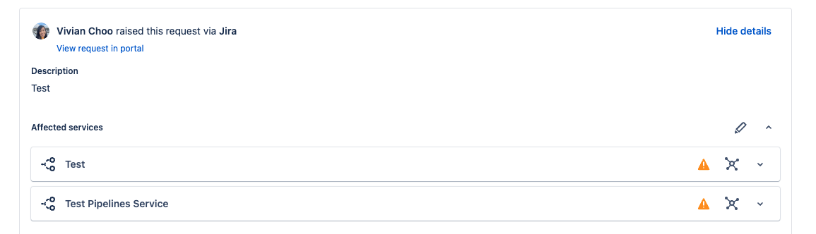

You would like to have an Assets object custom field that lists all objects in the object type, that is available for customers to use from the portal – and from there, automatically update the 'Affected services' field with the referenced services.

  1. On the Assets object schema and object type where you would like users to select objects from, make sure to add a 'Services' attribute that references the Services schema:

    1. Pick Issue Created trigger (Or any trigger depending on when you would like the 'Affected services' field to be updated)
    2. Then, add the 'Lookup objects' action. Select the Services schema and use the following query to look up all services that have a reference to the selected object on the custom field created in Step 2.
      1 object HAVING inR(objectType = "<Object Type Name>" AND Key in ({{issue.customfield_XXXX}}))
      ℹ️ Replace <Object Type Name> with your object type name and issue.customfield_XXXX with the custom field ID of the field created in Step 2.
    3. Add an Edit issue action. Under 'Additional fields', in additional fields, enter the following JSON to update the 'Affected services' field:
      1 2 3 4 5 6 7 8 9 { "fields": { "Affected services": [ {{#lookupObjects}} {"id": "{{Service ID}}"}{{^last}},{{/}} {{/}} ] } }
