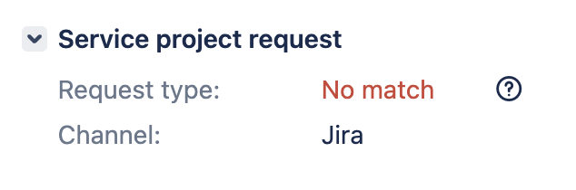

1 2 3 4 5 6 7 { "errorMessage": "The request could not be found, or you do not have permission to see it.", "i18nErrorMessage": { "i18nKey": "sd.attachment.error.issue.not.found", "parameters": [] } }
What this error means
This error occurs when the JSM Request does not have a Request Type set, as illustrated below:
This usually happens when the request was raised from the Jira UI instead or via the Customer Portal.
How to fix it
To fix this issue, add a value to the Request Type field.

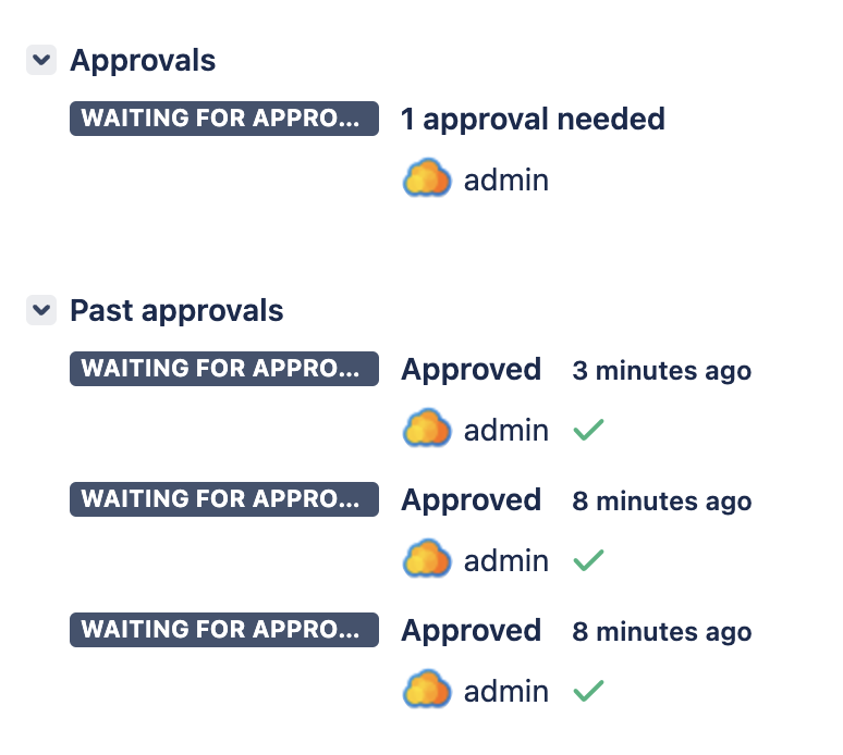

ℹ️ Please note that a JSM request might go through multiple approval cycles as illustrated below:
When using the GET request to fetch the list of approvals from this request, make sure to fetch the ID of the approval for which the finalDecision property is set to pending in the JSON response as illustrated below:
1 2 3 4 5 6 7 8 9 10 11 12 13 "values": [ { "id": "14", "name": "Waiting for approval", "finalDecision": "pending", "canAnswerApproval": true, "approvers": [ { "approver": { "name": "admin", "key": "admin", ...
