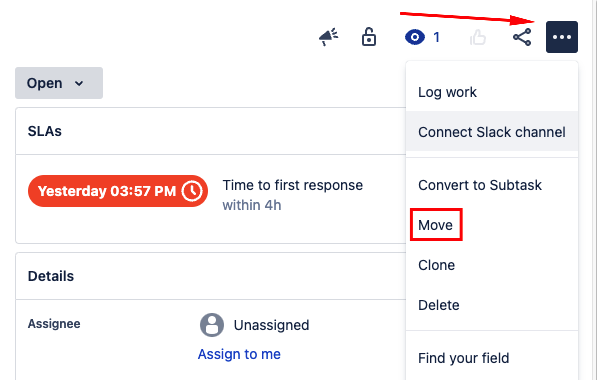

2nd Method: Using the "Move" action.
At the upper right corner from your Issue View, you may click at the Ellipsis icon (...) > Move. This will initiate the "Move Issue" procedure, where you can select a new Issue Type for your issue.

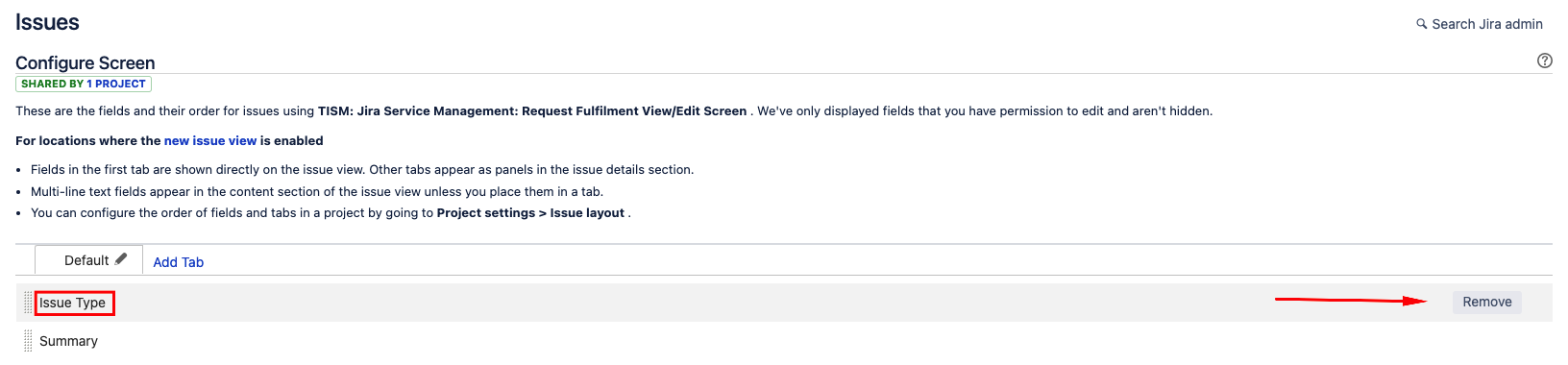

Prevent 1st Method:

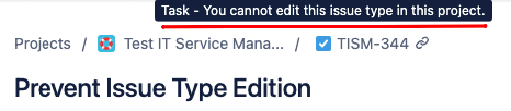

For every Issue Type in your project that you would like to prevent the 1st Method, you'll have to remove the "Issue Type" field, from the "View/Edit" screen.
After removing the "Issue Type" field from the needed screens, whenever your users try to click the Issue Type icon, they will see the following message:

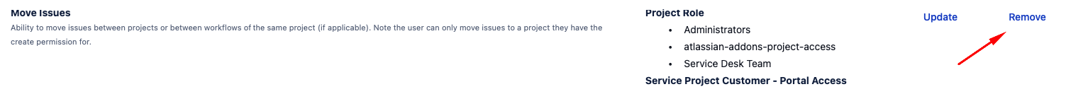

For this method you will need to update your project's Permission scheme. At your project go to Project settings > Permissions > Actions (cog icon) > Edit permissions. Scroll down until you reach the "Move Issues" permission and click Remove.
Select the users/groups/roles that you would like to remove the ability to move issues and click "Remove".

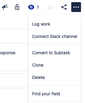

After performing the above steps, users without the "Move Issues" permission granted, will not be able to see the "Move" button at the Issue View.

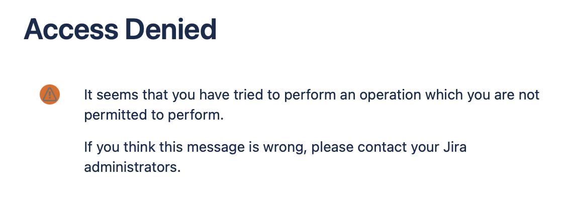

However, users will be able to select the Issue type icon in order to change it for a different issue type, but during the process, an Access denied error will appear:
