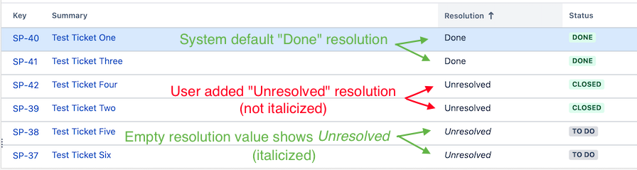

When using the Issue Navigator to find issues, the Resolution Unresolved appears twice, one of them being italicized.
example issue navigator results. some issues are listed with unresolved in standard text while others show unresolved in italics.

When an issue is opened in Jira, the default is that the Resolution field is empty - the term Unresolved is a system term which means the Resolution field has no value.
This problem occurs when a custom Resolution value of Unresolved is manually added under ⚙️Administration > Issues > Resolutions. When the Resolution field has no value, issues appear with the system default Unresolved in italics.
