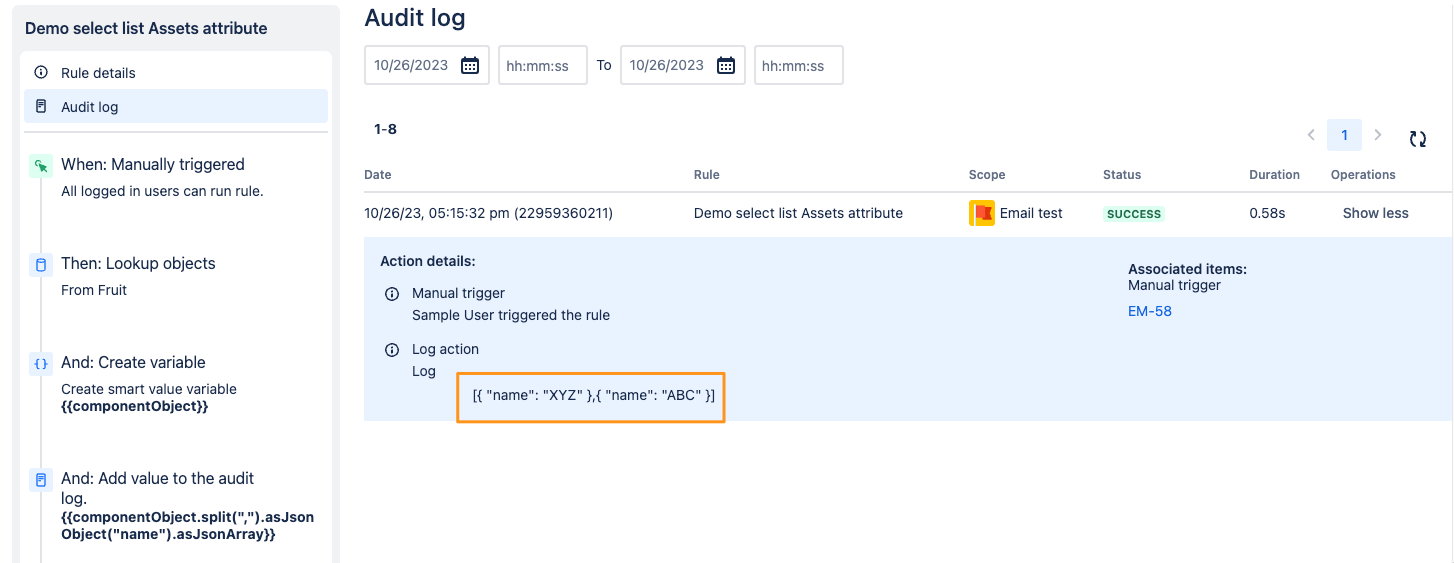

  4. As this example is for demonstration purposes, the result is captured in a log action, however the payload below can be used to edit an issue field via the advanced field editor in the Edit issue action. In this case the split function can be used to create a list of values that can be converted into a valid JSON payload using JSON functions:
    1 {{componentObject.split(",").asJsonObject("name").asJsonArray}}
The result of the above log action is shown in the screenshot below:
