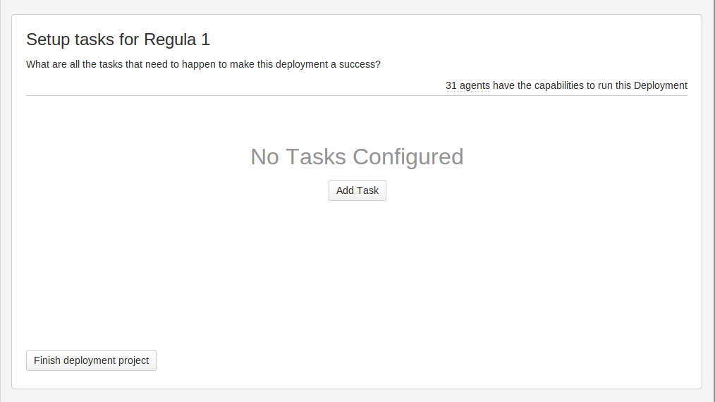

  1. Open your deployment project and expand the relevant environment panel. In the Other settings section, click on the Tasks button. The 'Set up tasks' screen will display:

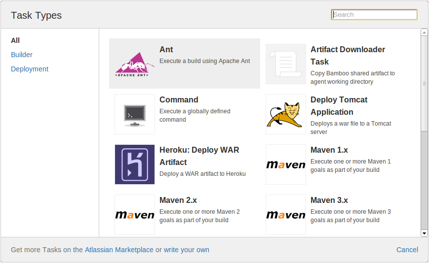

  2. From the Setup tasks screen, click on the Add Task button. The 'Task type' selection window will display:
  3. Click on the task type that you want to use. Only tasks applicable to the deployment environment will be available for selection. The task configuration window will open, and you can configure the task according to the needs of your deployment project. Different tasks will have different requirements

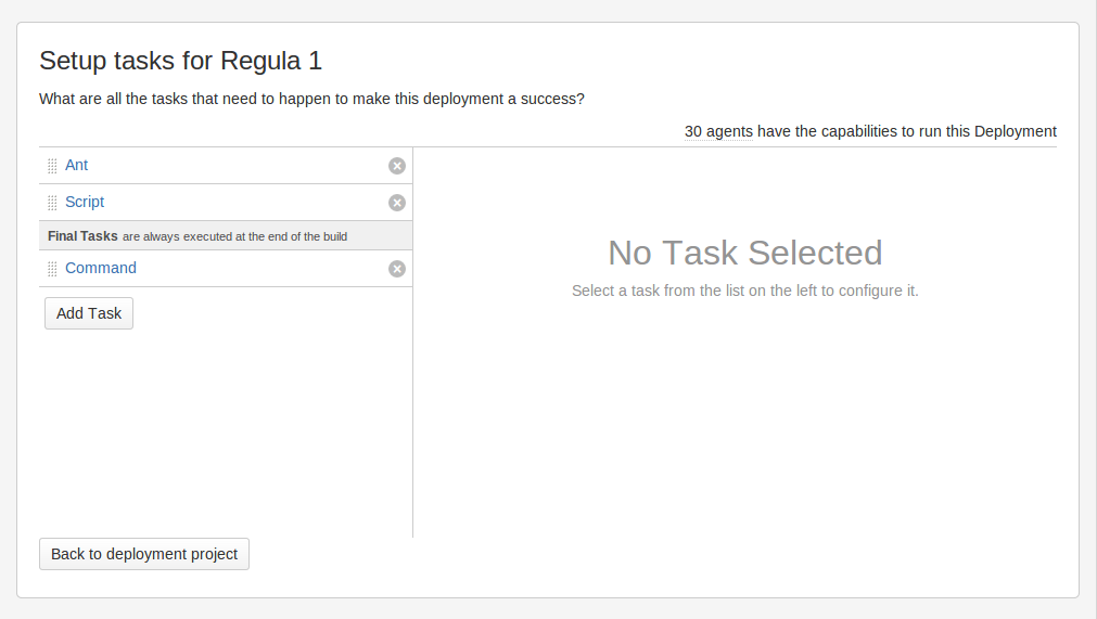

  4. Click on the Save button to save your task configuration. The Setup tasks screen will display again. Your newly configured task will display in the left side of the pane:

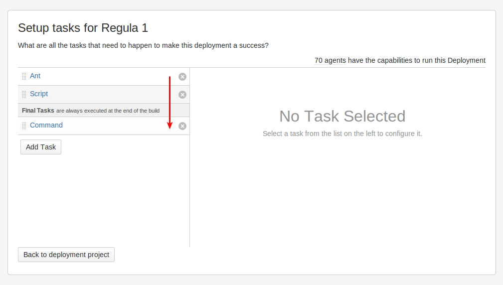

  1. Open your deployment project and expand the relevant environment panel. In the Other settings section, click on the Tasks button to display the 'Set up tasks' screen.
  2. To make a task a Final Task, simply drag the task beneath the Final Task bar in the Setup tasks window:
