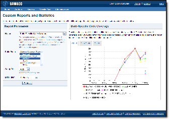

How well is the project being tested?
You just want a quick status check on the code coverage of the project. The coverage plugin is there for you. It provides a build coverage status box on the Code Coverage build plan tab that gives you just the facts: project coverage percentage, change since last build, and number of builds since coverage decreased.
Are the project's tests getting better or worse?
One way to answer this question is to look at how the project's code coverage has changed over time. The coverage plugin allows you to see this information by charting code coverage over time. Coverage for the project scope is charted for all available granularities and the result is placed on the Code Coverage tab on the build plan page.
Who is helping the project's testing, and who is holding it back?
To help answer this question, the coverage plugin charts code coverage change by author over time. For each author, the chart shows whether they have tended to increase or decrease the code coverage of the project over a period of time. The chart is displayed on the new Code Coverage tab on the build plan page.
Where is the project's testing changing?
You just noticed that your project's code coverage has increased (or decreased) dramatically in the last few builds. Now you want to know where the project coverage has improved (or declined). The coverage plugin makes this easy by displaying the 5 classes with the best and worst change in code coverage for each build. This information is displayed on the Code Coverage tab of the build results page. Each class listed is hightlighted in red or green (depending on the nature of the change) and shaded based on the magnitude of the change.
What's that you say? Too many classes have changed to get an accurate picture of what is going on? The coverage plugin also displays the 5 packages with the best and worst change in code coverage for each build. This information is also displayed on the Code Coverage tab of the build results page.
Still can't find out why the project's coverage is changing? It could be due to new classes that were added to the project in this build. Since there are no coverage statistics for these classes in the previous build, their change since the last build cannot be calculated. This means that they will not be displayed in the list of best and worst coverage change. The coverage plugin does display a list of new classes for the build, along with their code coverage percentage, so that you can determine if new classes are the culprit (or benefactor). Just in case you did some major refactoring and there are lots of new classes, there list is limited to 25 entries. Don't worry, it will tell you if it is being filtered. This information is displayed on the Code Coverage tab of the build results page.
How does this project's testing compare to others?
Now that you have the project's code coverage heading in the right direction, you probably want to know how all the other projects stack up against it. The coverage plugin provides two reports that let you do exactly that. The Build-Specific Code Coverage report charts the code coverage of multiple projects over time.
The Build-Specific Code Coverage Delta By Author (wow, that's a mouthful) report tracks code coverage change by author over time. It combines this data from multiple projects onto the same chart for easy comparison.
How well are all projects being tested?
There's probably one last question that you're asking yourself. What does total code coverage look like across all projects? The code coverage plugin includes two reports that help answer this very question. The Code Coverage report sums up the code coverage across multiple projects for all available granularities and charts it over time.
The Code Coverage Change By Author report sums up the coverage deltas for each author across multiple projects and charts it over time.

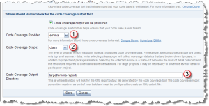

  2. Place the bamboo-coverage-plugin-x.x.jar file in <Bamboo install directory>/webapp/WEB-INF/lib. Start or restart the Bamboo server.
  3. If you are configuring a new build plan, follow the normal process until you reach the Builder Configuration tab. If you are enabling the plugin for an existing build plan, go to the Configuration tab and then the Builder Configuration subtab. Change the subtab to edit mode.
  4. You should see a section on this page with the header "Where should Bamboo look for the code coverage output file?". Select the "Code coverage output will be produced" checkbox and some additional fields will appear.
  5. Select the code coverage tool that you are using from the "Code Coverage Provider" dropdown.
  6. Select the desired value for "Code Coverage Scope". It is recommended that this be set to "class", since this setting will provide the most detailed insight into the code coverage of your build. However, this plugin has not been tested extensively on large projects and it may be necessary to select a less detailed level of reporting in order to conserve resources.
  7. Enter the location of your build's XML code coverage report in the "Code Coverage Output Directory" field. The field will accept the path to a directory, the path to a specific file, an Ant-style pattern that identifies one or more files, or a comma-separate list of these values. All values entered in this field are relative to the root directory of your project. Typically, entering the relative path to the directory containing the coverage output file is sufficient. If there are other XML files in the same directory as the coverage output file, these files will be examined by the coverage plugin, but not processed. The coverage plugin checks the format of the coverage files before loading them and will skip any files that do not appear to be valid. However, if you would like to avoid having other files examined, especially if they are large files, then a pattern that specifically identifies the coverage report file can be provided. For example, assume you have a project located in the directory /projects/cool_app and the build for this project produces the file /projects/cool_app/target/emma/coverage.xml containing code coverage data. The output directory field should be set to target/emma for this build. If there are other XML files in the same directory that should not be parsed, then the output directory should be set to target/emma/coverage.xml.
  8. Configure any other required build plan settings and save your changes.
  9. Execute your build plan.
