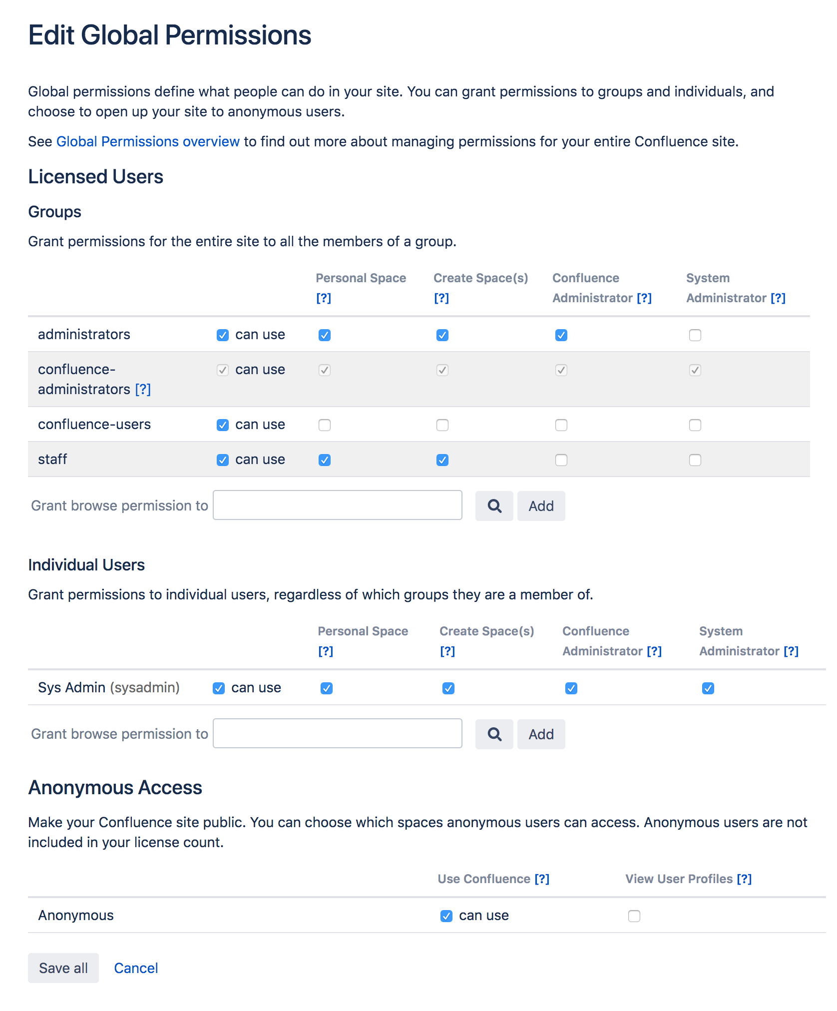

Grant global permissions
To grant global permissions to a user or group:
  1. Go to Administration menu , then General Configuration > Global Permissions
  2. Select Edit Permissions
  3. Do one of the following:
    1. Enter a group name in the Grant browse permissions field in the Group section
    2. Enter a username in the Grant browse permissions field in the Individual Users section
  4. Select Add.
  5. The user or group will appear in the list. Select the permissions you want to grant.
  6. Select Save all
Screenshot: Editing global permissions
