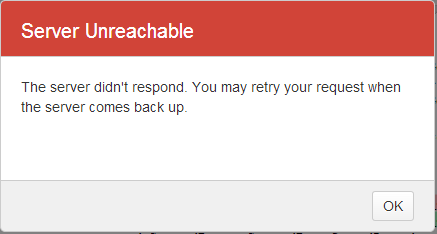

Upon merging a pull request the merge dialog will be displayed for around 30 seconds before timing out with "Server Unreachable – The server didn't respond. You may retry your request when the server comes back up." Note that refreshing the page in the browser actually shows that the pull request was merged. The "Delete Branch" option doesn't work and the timeout message is also seen when viewing the diff of a pull request. Also, pushing code via command-line gets to the point where all objects are written 100% and then pauses for ~45 seconds before finally completing.
Message seen on the screen:
