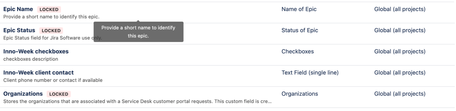

What you see on the server:
What you can potentially see in Cloud:
Duplicate entities will be flagged as “(migrated), (migrated 1), (migrated 2) etc.” in the destination site depending on the number of migrations that were affected by this behavior. Large amounts of duplication (e.g. 20 duplicates for each custom field) may cause performance issues.
