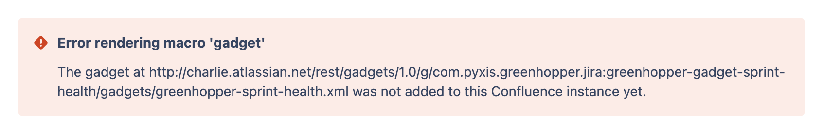

Jira Gadgets are not working in Confluence with the following error:
Error in text format
1 2 3 Error rendering macro 'gadget' The gadget at http://charlie.atlassian.net/rest/gadgets/1.0/g/com.pyxis.greenhopper.jira:greenhopper-gadget-sprint-health/gadgets/greenhopper-sprint-health.xml was not added to this Confluence instance yet.
The Sprint Health Gadget was used as an example here, but other Jira Gadgets can be affected the same way.
