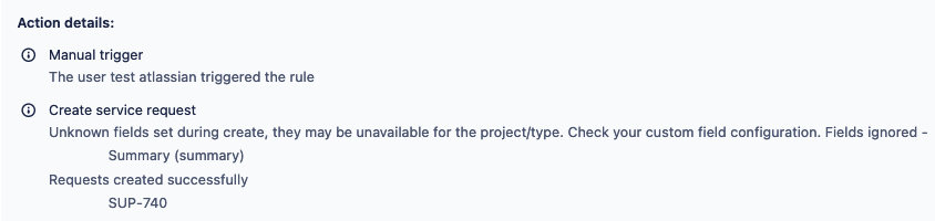

When the Create service request action is used in an Automation rule for a Request Type with hidden fields, you will see them marked as (deleted field?).
If you try to set them within the action, the automation rule will fail with the following:
Unknown fields set during create, they may be unavailable for the project/type. Check your custom field configuration. Fields ignored - [Your hidden field]
The impact is greater when the field is required, as you can't leave the field empty.
