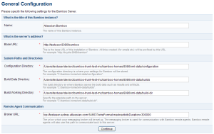

Step 2. General Configuration
(info) This step applies to the 'Custom Installation' method only.
Screenshot: General Configuration (click to view larger image)
On this page, you need to specify a number of Bamboo server settings, such as the address of the server, where data is stored and the message broker used to communicate with remote agents.
  • 'Name' — for more details please see Specifying Bamboo's Title.
  • 'Base URL' — for more details please see Specifying Bamboo's URL.
  • 'Configuration Directory' — This is where Bamboo will store its configuration files.
  • 'Build Data Directory' — This is where Bamboo will store its project data files.
  • 'Build Working Directory' — This is where Bamboo will check out project files from source control.
    (warning) You may find it simplest to keep the default settings for the above three directories. For more information please see Locating Important Directories and Files.
  • 'Broker URL' — This field will only display if you are permitted remote agents under your Bamboo license. The Broker URL is the URL of the embedded messaging broker that Bamboo sets up to communicate with its remote build agents. This URL will be written to bamboo.cfg.xml as a property. You can update this file if you want to change your Broker URL.
    • Replace localhost with the real host name or IP address of your Bamboo server. You should not use localhost as the host name in the Broker URL, as remote agents are provided with the Broker URL on startup and use it to communicate to the server.
    • If port number 54663 is already in use, specify a different port number.
