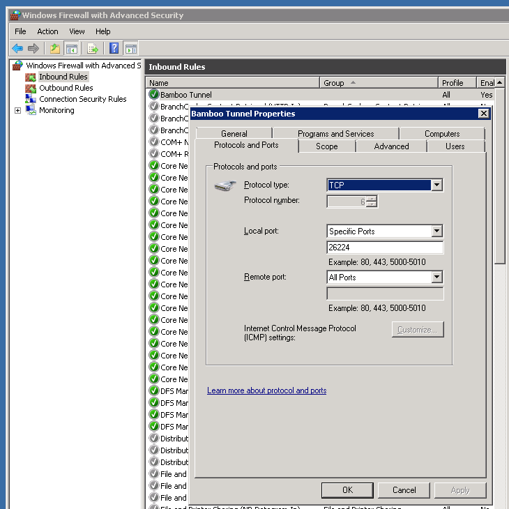

Reconfigure the Windows firewall to accept TCP connections on port 26224. No other inbound connections are necessary for Bamboo.
You don’t need to worry about changing the EC2 security group setting for this port, Bamboo will set it up automatically:

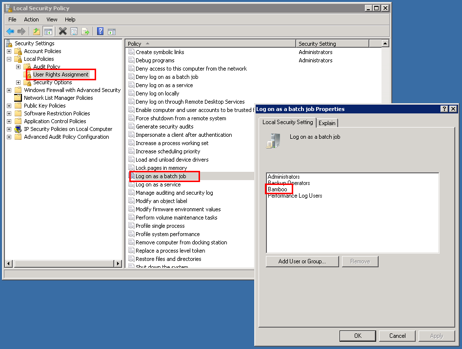

The task manager will warn you that the account needs to be able to log in as a batch job. Make sure the “Log on as batch job” policy is set for the user. This policy is accessible by opening the Control Panel -> Administrative Tools -> Local Security Policy. In the Local Security Policy window, click Local Policies -> User Rights Assignment -> Log on as batch job:

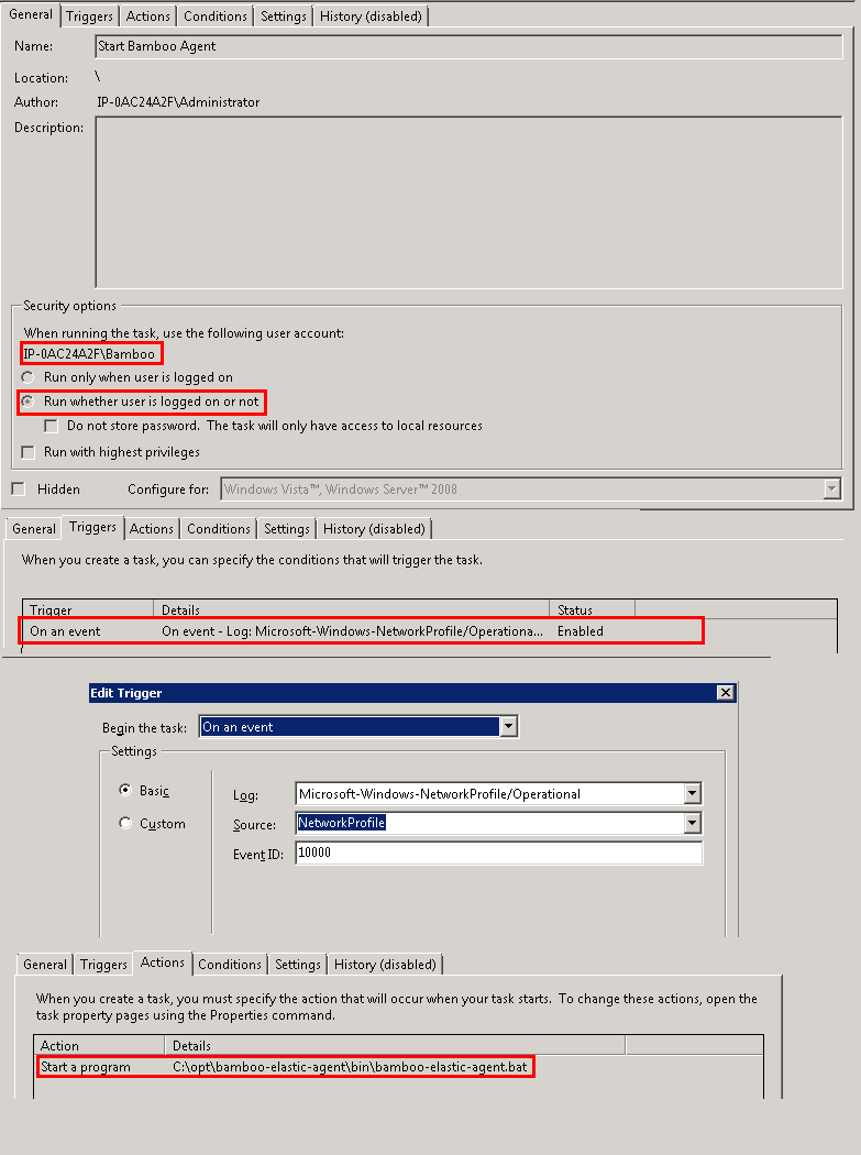

The easiest way to check if everything is set up correctly, is to run the task you've defined using Windows Task Scheduler (Start->Administrative Tools->Task Scheduler). Right click on the task and select "Run". Always test the script using the Task Scheduler - if you run the script manually, you'll use Administrator account, which is not what we want.
Look for the %USERPROFILE%/bamboo-elastic-agent.out file. If it exists and contains an error message stating that agent was not run within an EC2 instance started by Bamboo Server, you’ve successfully completed the customisation.
