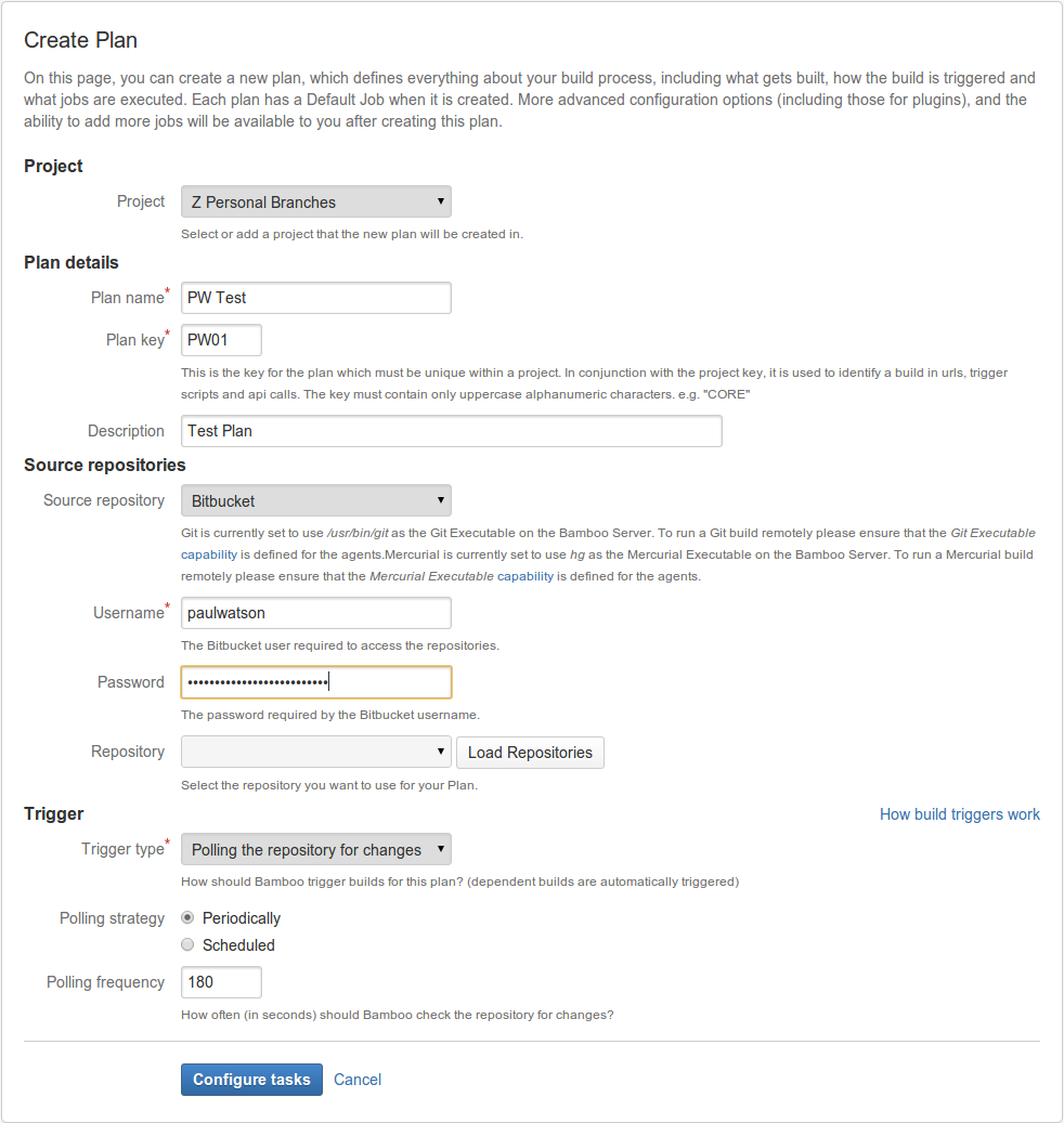

When you create a new plan, you can define everything about your build process, including what gets built, how the plan's build is triggered and what jobs are executed.
To create a new plan, complete the following sections:
  1. Click Create > Create a New Plan in the top menu bar
  2. Complete the following sections:
    ProjectThe project that the new plan will be created in. You may choose an existing project, or start a new one
    Plan DetailsSelect either an existing project to which this new plan will belong, or New Project.
    Source RepositoriesSee the following for details:
    Trigger
    Choose how Bamboo should trigger builds. See Triggering builds.
Screenshots: Creating a new plan
