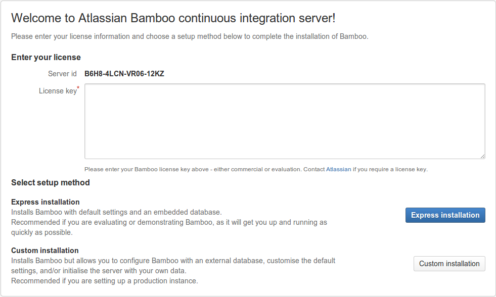

Step 1. License Details and Setup Method
You must have a valid Bamboo license (evaluation or commercial) to use Bamboo. You can generate your own Bamboo evaluation license from your MyAtlassian self-service account here. If you have any problems with this, please email sales.
Once you have entered a valid license key, you can choose which setup method you prefer for your Bamboo installation:
Express Installationwe recommend that you choose this method if you are evaluating or demonstrating Bamboo.
  • The 'Express Installation' method requires only a minimum of configuration information. It sets up Bamboo with default settings and an embedded database (HSQL).
  • If you choose the 'Express Installation' method you can skip to Step 6. Set Up Administrator User below.
Custom Installationwe recommend that you choose this method if you are setting up a production instance of Bamboo.
  • The 'Custom Installation' method takes longer, but allows you to configure Bamboo with an external database, customise the default settings, and/or initialise the server with your own data.
  • If you choose, the 'Custom Installation' method, proceed to Step 2. General Configuration below.

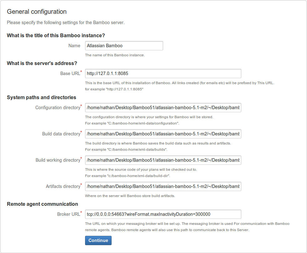

(info) This step applies to the 'Custom Installation' method only.
On this page you specify a number of Bamboo server settings, such as the address of the server, where data is stored and the message broker used to communicate with remote agents.
(warning) You may find it simplest to keep the default settings for the three directory settings, in the table. For more information please see Locating important directories and files.
SettingDetails
NameSee Specifying Bamboo's Title
Base URLSee Specifying Bamboo's URL
Configuration DirectoryThe location for Bamboo configuration files.
Build Data DirectoryThe location for Bamboo project data files.
Build Working DirectoryThe location of project files checked out from source control.
Broker URL
Only visible if you are permitted remote agents under your Bamboo license.
The URL of the embedded messaging broker that Bamboo sets up to communicate with its remote build agents. This URL will be written to bamboo.cfg.xml as a property. You can update this file if you want to change your Broker URL.
  • Replace localhost with the real host name or IP address of your Bamboo server. You should not use localhost as the host name in the Broker URL, as remote agents are provided with the Broker URL on startup and use it to communicate to the server.
  • If port number 54663 is already in use, specify a different port number.

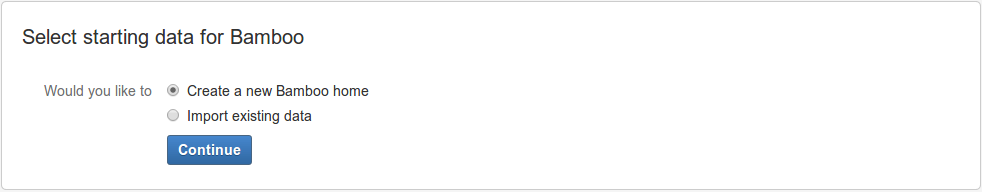

Step 5. Starting Data
Screenshot: Starting Data
On this page you specify how Bamboo will populate the 'home directory' that you set up when you installed Bamboo.
Choose one of the following:
  • Create new Bamboo home — choose this if you are performing a normal installation or upgrade.
  • Import existing data — only choose this under exceptional circumstances, e.g. if you are connecting Bamboo to a different database, or moving your pre-existing Bamboo installation to a different server. Avoid importing backups from different versions of Bamboo.
