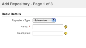

Repository Type
Choose Subversion.
Name
A name for this repository. The name may contain alphanumeric, underscore, '-' or '.' characters. Use 'svn' if you can't think of a better name.
Description
A short description of this repository.

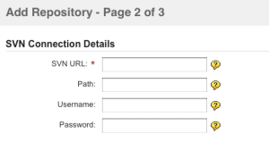

SVN URL
The Subversion Repository Root URL to your repository, such as svn://svn.foo.com or file:///var/svn. If you are not sure what your repository root is, check the section below "Finding your Repository Root".
(Please note that file protocol performs the fastest followed by svn and lastly by http/s. Therefore where possible please use the file protocol.)
Path
The sub-tree within your repository that FishEye should display. If this value is '.' (or empty), then the whole repository will be shown.
Username/Password
The credentials to use if your repository requires authentication. See also SVN Authentication Issues.

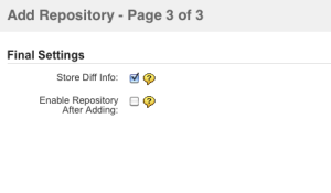

Store Diff Info
Enable this option if you are using the Subversion or Perforce SCM systems and making use of per-author line counts. Otherwise, enabling this option is not necessary. Read more information
Enable Repository After Adding
Controls whether FishEye will immediately enable this repository, which starts the initial scan. If you wish to do some further configuration before the scan starts, then do not check. You can enable a repository later from the repository list.
