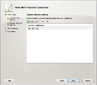

Remote Network settings window
  1. Select "Add"
  2. Enter the IP address of the JIRA server
  3. Hit OK
  4. Delete the default 0.0.0.0-255.255.255.255 range
  5. Hit Next

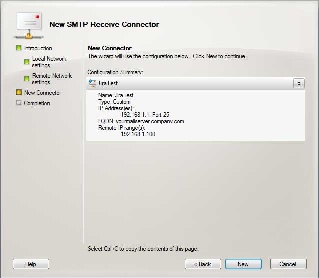

New Connector window
  1. It should now be possible to see an overview of the connector being creating
  2. Hit New

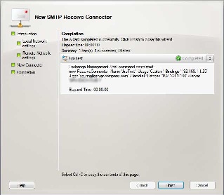

Completion window
  1. Hopefully this shows the connector completed successfully
  2. Hit Finish

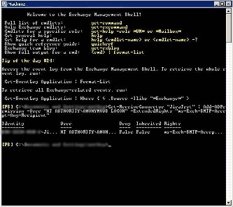

  • Normally that should be it, but it's not. There is one more additional step that which needs to be done in PowerShell.
  • Open up the Exchange Management Shell and type the following, where "JiraTest" is the name of the connector that was just created.
Get-ReceiveConnector "JiraTest" | Add-ADPermission -User "NT AUTHORITY\ANONYMOUS LOGON" -ExtendedRights "ms-Exch-SMTP-Accept-Any-Recipient"
What this command does is grant the relay permission to the Anonymous group for that connector.  When simply selecting Anonymous Users through the GUI all that is assigned is the most common permissions, but it does not grant the relay permission. So now run the command through Management Shell.
