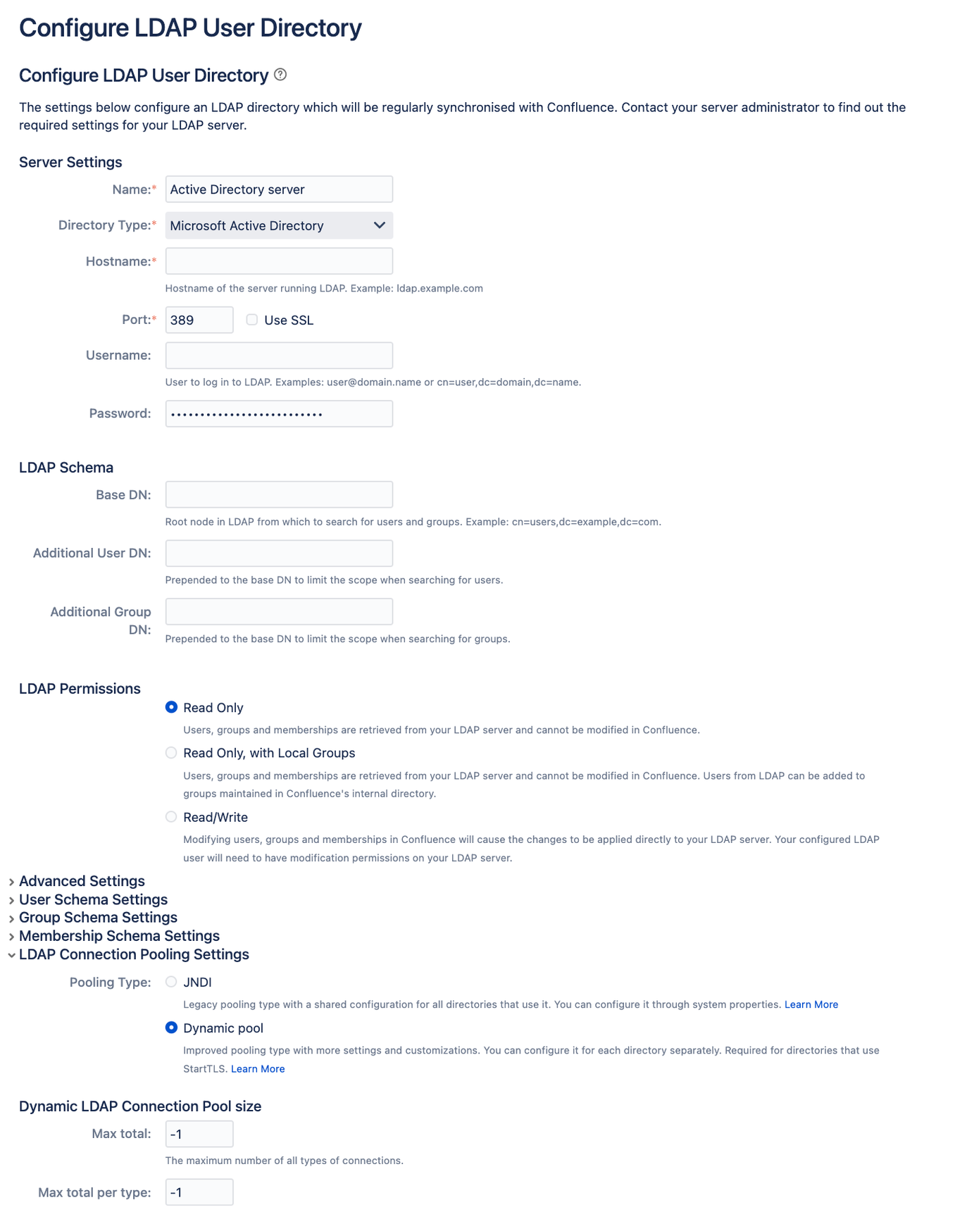

To enable the Dynamic LDAP connection pool for a directory:
Go to Administration > User management.
Select User Directories from the side menu.
From the list, choose an existing connector or delegated directory and select Edit.
Expand the LDAP Connection Pooling tab.
Select the Dynamic pool option.
Configure the parameters. You can find more information about them in the table below.

Pool size
Dynamic pool parameter | Description | Default value |
Max total | The maximum number of active connections (for all types) that can be allocated from the pool at the same time. A non-positive value sets the number to unlimited. | -1 |
Max total per type | The limit of connection slots allocated by the pool (checked out or idle), per key. Each key type determines a sub-pool of read-only or read-write connections. When the limit is reached, the sub-pool is exhausted. A non-positive value sets the number to unlimited. | -1 |
Max idle per type | The maximum number of active connections of each key type (read-only and read-write) that can remain idle in the pool without extra connections being released. Each key type determines a sub-pool of read-only and read-write connections. A non-positive value sets the number to unlimited. | -1 |
Min idle per type | The minimum number of active connections of each key type (read-only and read-write) that can remain idle in the pool, without extra connections being created. Each key type determines a sub-pool of read-only and read-write connections. A non-positive value sets the number to unlimited. | 0 |
