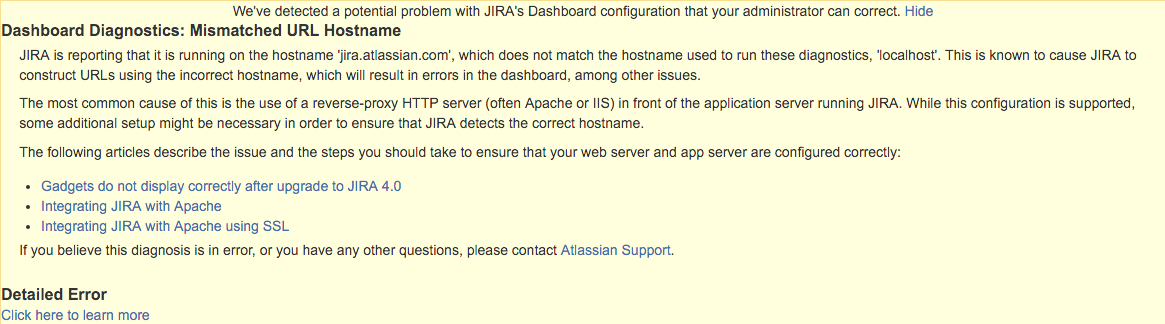

- If the context path is empty or root (
/), visiting Jira via the proxy connector (e.g.http://jiraserver:8080/) should take you to Jira with a warning: - If the context path is other than empty or root (
/), e.g./jira, visiting Jira via the proxy connector (e.g.http://jiraserver:8080/jira) should redirect you to the configured proxy (e.g.https://jira.atlassian.com/jira).
