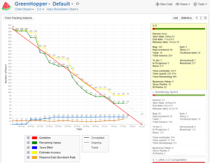

The GreenHopper Classic Chart Board provides you with a graphical representation of the progress of ongoing versions. You can view 'burndown' graphs that show the number of incomplete issues that need to be addressed or hours remaining to complete work for a specified version, over the duration of that version. You can also view 'burnup' graphs to show other custom data associated with issues, such as business value.
All graphs can show a range of additional trend lines to help you monitor and manage the progress of work conducted in your team.
To view the hour burndown chart for your project version,
- Log into JIRA.
Select 'Agile' > 'Classic' in the top navigation bar. Then select 'Classic Chart Board' from the drop-down below the project name.
- Select your project from the project dropdown (top left of the Chart Board above the 'Chart Board' dropdown), if it is not already selected. The 'Chart Board' will refresh with information for your project.
Tip: You can configure your Chart Board context and user preferences to personalise your Chart Board.
Screenshot: GreenHopper Classic Chart Board (click to view larger image)
The screenshot above shows an example Chart Board. To learn more about how to use the Chart Board, please see the sections below and the documentation linked from those sections.

Classic Chart Board - Displayed Chart
The actual display will depend on which chart you have selected. See:
Classic Chart Board — Statistics Column
To select a box, click inside it and once selected, the box turns yellow. The content on the rest of the Board you are viewing will be updated to show the data associated with that box.
