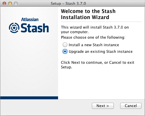

At the 'Welcome' step, choose the Upgrade an existing Stash instance option:

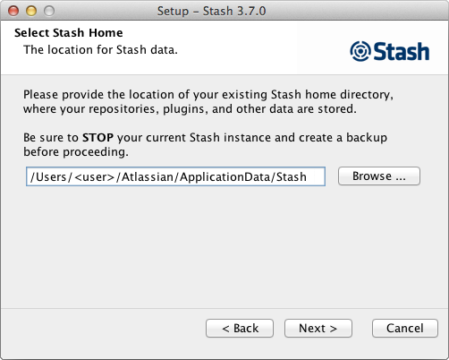

At the 'Select Stash Home' step, browse to your existing Stash home directory (as defined by the STASH_HOME environment variable – see Stash home directory):
Stash 3.5 and later versions no longer allow the Stash home directory to be the same directory as, or a subdirectory of, the Stash installation directory. The Stash home directory, as defined by the STASH_HOME  environment variable, must be in a separate location – otherwise Stash will fail on startup.
If upgrading from a previous version of Stash where the Stash home directory is owned by a local user, the ownership of all files will be updated to atlstash . Please allow sufficient time for the installer to complete this process (it could take up to 30 minutes) .

Use the Stash installer to update your Stash installation (Recommended)
Download the Stash installer from the Atlassian download site. You can run the installer in GUI, console or unattended modes.
On Linux, you need to set the executable flag on the installer file before running it:
chmod +x atlassian-stash-x.x.x-x64.bin
