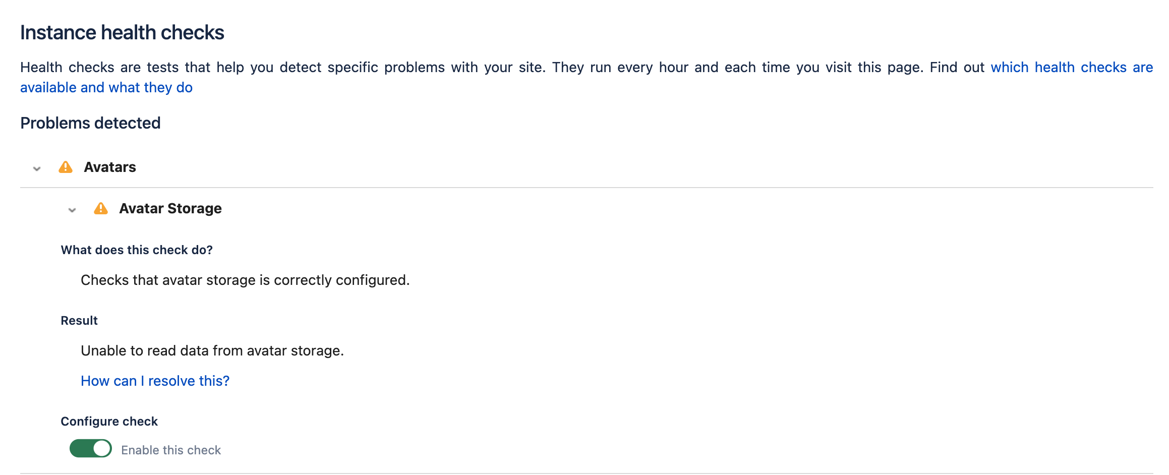

Troubleshooting S3 avatar storage
When Jira starts up, it runs a series of checks to make sure there are no issues with the filestore-config.xml file. If there are any errors during the file parsing, Jira won't start and display an error message.
In the case there some problems with connecting to or performing operations on S3, Jira will also detect them and flag the Avatars instance health check as failing.
The following sections list the problems that can happen during S3 configuration along with the resolution steps. The issues are mainly related to improper S3 configuration, permissions, or authentication.

Health check failures
Learn more about the instance health checks and how they are performed. Learn more about instance health checks
Problem | Root cause & resolution |
Unable to list the contents of avatar storage | This health check can fail due to the following reasons:
If you need help with diagnosing the issue, check the logs in |
Unable to read data from avatar storage | The
Unable to write to avatar storage | The
Unable to delete files from avatar storage | The
