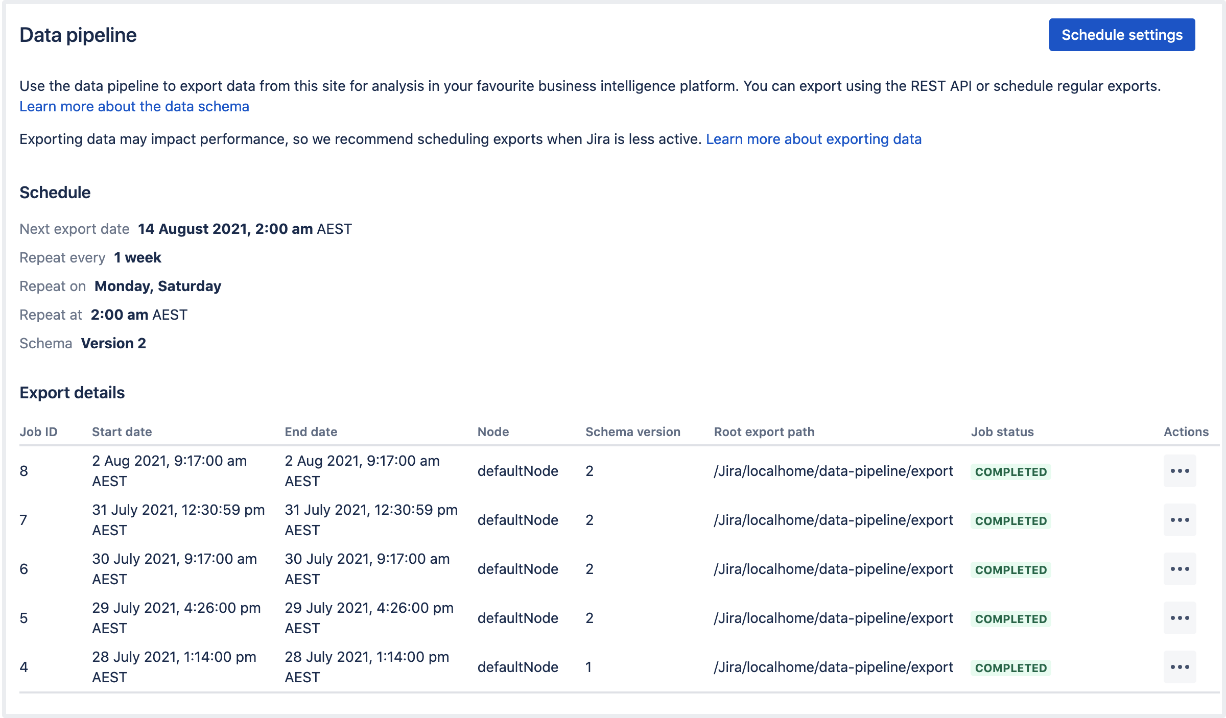

Access the data pipeline
To access the data pipeline select  > Data pipeline.
Schedule regular exports
The way to get the most value out of the data pipeline is to schedule regular exports. The data pipeline performs a full export every time, so if you have a large site, you may want to only export once a week.
To set the export schedule:
  1. From the Data pipeline screen, select Schedule settings.
  2. Select the Schedule regular exports checkbox.
  3. Select the date to include data from. Data from before this date won’t be included. This is usually set to 12 months or less.
  4. Choose how often to repeat the export.
  5. Select a time to start the export. You may want to schedule the export to happen outside working hours.
  6. Select the Schema version to use (if more than one schema is available).
  7. Save your schedule.

Check the status of an export
You can check the status of an export and view when your last export ran from the data pipeline screen.
The Export details table will show the most recent exports, and the current status.
Select   > View details to see the full details of the export in JSON format. Details include the export parameters, status, and any errors returned if the export failed.
For help resolving failed or cancelled exports, see Data pipeline troubleshooting
