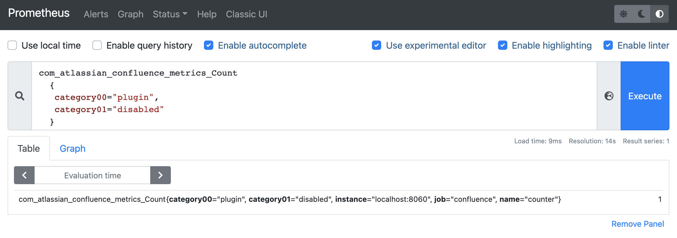

Perform a simple query
You can confirm that Prometheus is receiving app metrics with a simple test.
Go to Administration menu then Manage apps and temporarily disable an app (such as the Confluence Migration Assistant, don't disable anything that will interrupt your users).
In Prometheus, run the following query:
com_atlassian_confluence_metrics_Count
   category00="plugin",
   category01="disabled"
This will return the number of times an app has been disabled since monitoring was turned on.

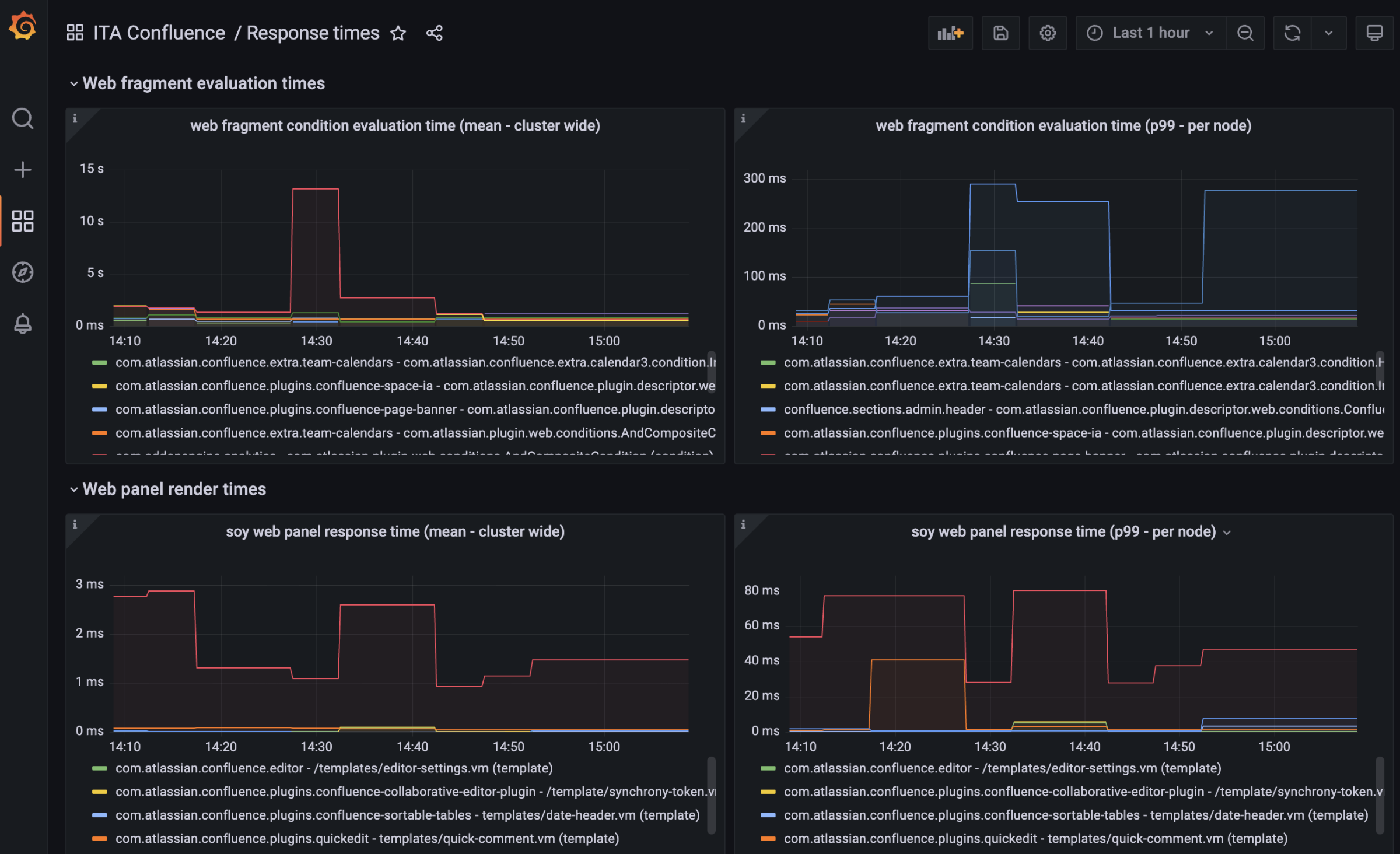

Here's an example of a dashboard in Grafana showing response times for various plugins.
