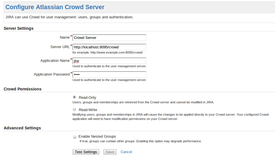

2.1 Add a Crowd Directory in Jira
Jira can use Crowd for user authentication simply by adding 'Atlassian Crowd' as user directory.
  1. Login to the administration section of Jira
  2. Click on the 'User Directories' label of the left bar under the 'User management'. tab.
  3. Click 'Add Directory'. Then select 'Atlassian Crowd' from the dropdown list. Click 'Next'.
  4. Enter connection parameters and save. If you configure Server URL to use HTTPS, by replacing http:// with https://, communications between Jira and Crowd will be encrypted.
  5. Now a new Crowd directory should appear on the user directory list.
For more information on configuring a Crowd directory in Jira, check out the Jira documentation on Connecting to Crowd or Another Jira Server for User Management.
