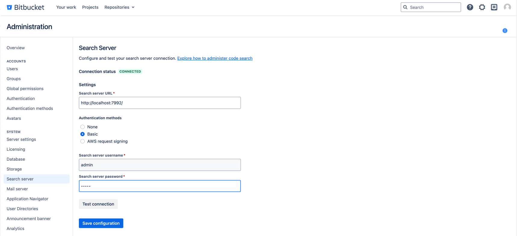

Change the connection details for accessing the search server
There are two ways you can change the connection details Bitbucket uses to access the search server:
  1. Configure the details of your search server within the Bitbucket UI, or
  2. Configure the details of your search server within the  bitbucket.properties  file.
If a search server parameter is set from within the bitbucket.properties file, it cannot be edited later from the admin UI . Any changes that need to be made to the search server configuration, must be made within the  bitbucket.properties  file.
To change the connection details for accessing the search server from the Bitbucket UI...
Go to  > Search server
Here, you can see the search server's current configuration, including the URL and different authentication methods for accessing it.
