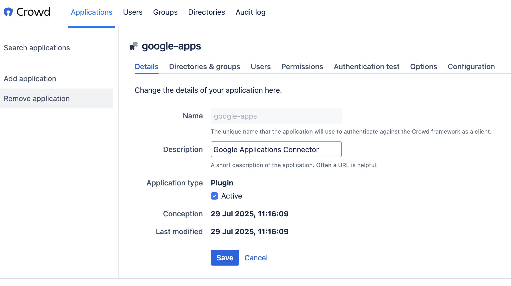

Removing Google Apps connector
Starting from Crowd 7.0, the Google Apps connector functionality is blocked by default. However, the Google Apps connector configuration isn't automatically removed and you can see the following warning message: "The Google Apps connector is enabled in your Crowd instance. This connector is no longer supported and will be removed in future Crowd versions. We recommend that you disable the connector and remove it from your instance."
To permanently remove the Google Apps connector:
- Log in to Crowd.
- Go to the Applications tab.
- Select Google Apps.
- Select Remove application and confirm removal.
After removing the connector, the warning message will disappear.

Step 1. Configuring the Crowd Application, Directory and Group Details
In this step, you will enter the application details for the Google Apps application connector in Crowd. You will manage access to Google Apps by associating Crowd directories and/or groups with the Google Apps application.
To define the Google Apps application details in Crowd:
- Log in to the Crowd Administration Console.
- Click the Applications tab in the top navigation bar.
- Click the link on the 'google-apps' application name.
- If required, you can change the description. Please ensure that the Active checkbox remains ticked.
- Click the Directories tab and select one or more user directories that contain the users who should have access to Google Apps.
- To choose which users within the directory may authenticate against the application, either:
- On the Directories tab, change Allow all to authenticate to True. This will allow all users in that directory to log in to Google Apps. (The default is False.)
OR - On the Groups tab, use the Add button to select one or more groups of users.
- Click the Permissions tab and set the directory permissions for the application.
- If required, you can change the application options on the Options tab:
- Lower Case Output — See Enforcing Lower-Case Usernames and Groups for an Application.
- Enable Aliasing — See Specifying a User's Aliases.
- Click the Configuration tab and generate your SSO keys as described in Step 2 below.
Screenshot: Google Apps application details in Crowd

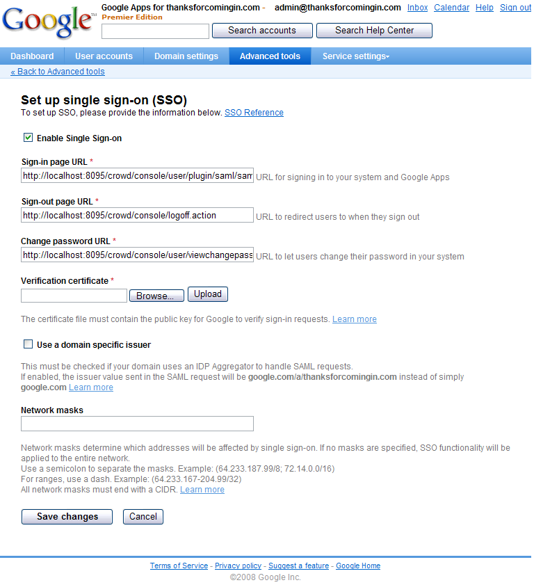

Step 3. Configuring Google Apps to Recognize Crowd
In this step, you will log in to Google Apps as an administrator and enter the information required for Crowd to authenticate to Google Apps. This information consists of some Crowd URLs and the public key which you generated from Crowd.
To configure Google Apps to recognize Crowd:
- Log in to your Google Apps Dashboard as a Google Apps administrator.
- In Google Apps, click Security.
- Click Advanced Settings.
- Click Set up single sign-on (SSO).
- Copy the URLs from the Crowd configuration screen (see above) and paste them into the Google Apps screen.
- Now you will upload the public key which Crowd generated for you in Step 2above:
- Still in Google Apps, click Browse under 'Verification certificate'.
- Navigate in Crowd to google-aps configuration and download the public key clicking on button Download next to the Public Key label.
- Select the public key certificate (file name
DSAPublic.key) and upload it to Google Apps.
- If necessary for your network configuration, check Use a domain specific issuer and enter any required network masks in Google Apps. Please refer to the Google Apps documentation for guidance on these settings.
- Save your changes in Google Apps.
Screenshot: Setting up SSO in Google Apps

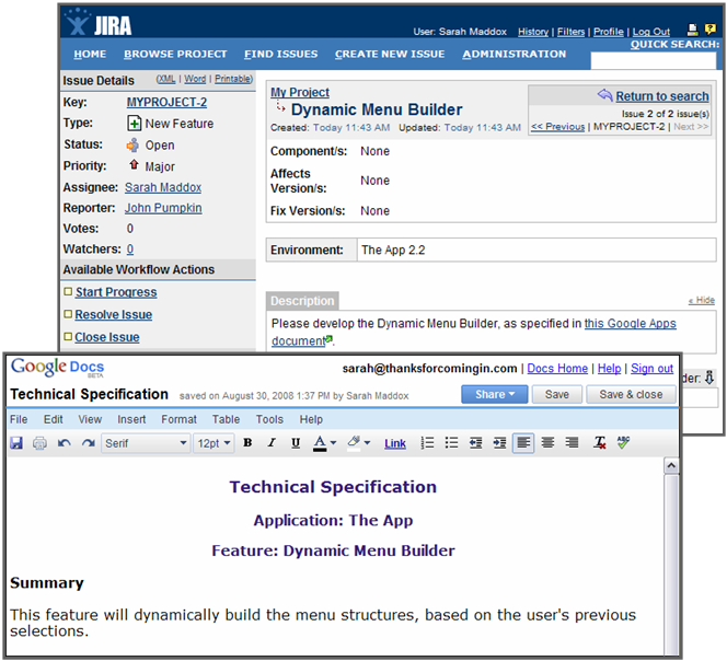

An Example of Google Apps SSO in Action
Here's one example of how it might work:
- John raises an issue in Jira. In the issue description, he adds a link to a Google Apps document containing more details.
- He assigns the issue to Sarah.
- Sarah clicks the link and opens the document directly in Google Apps. No need to log in again, no need to remember a different password.
