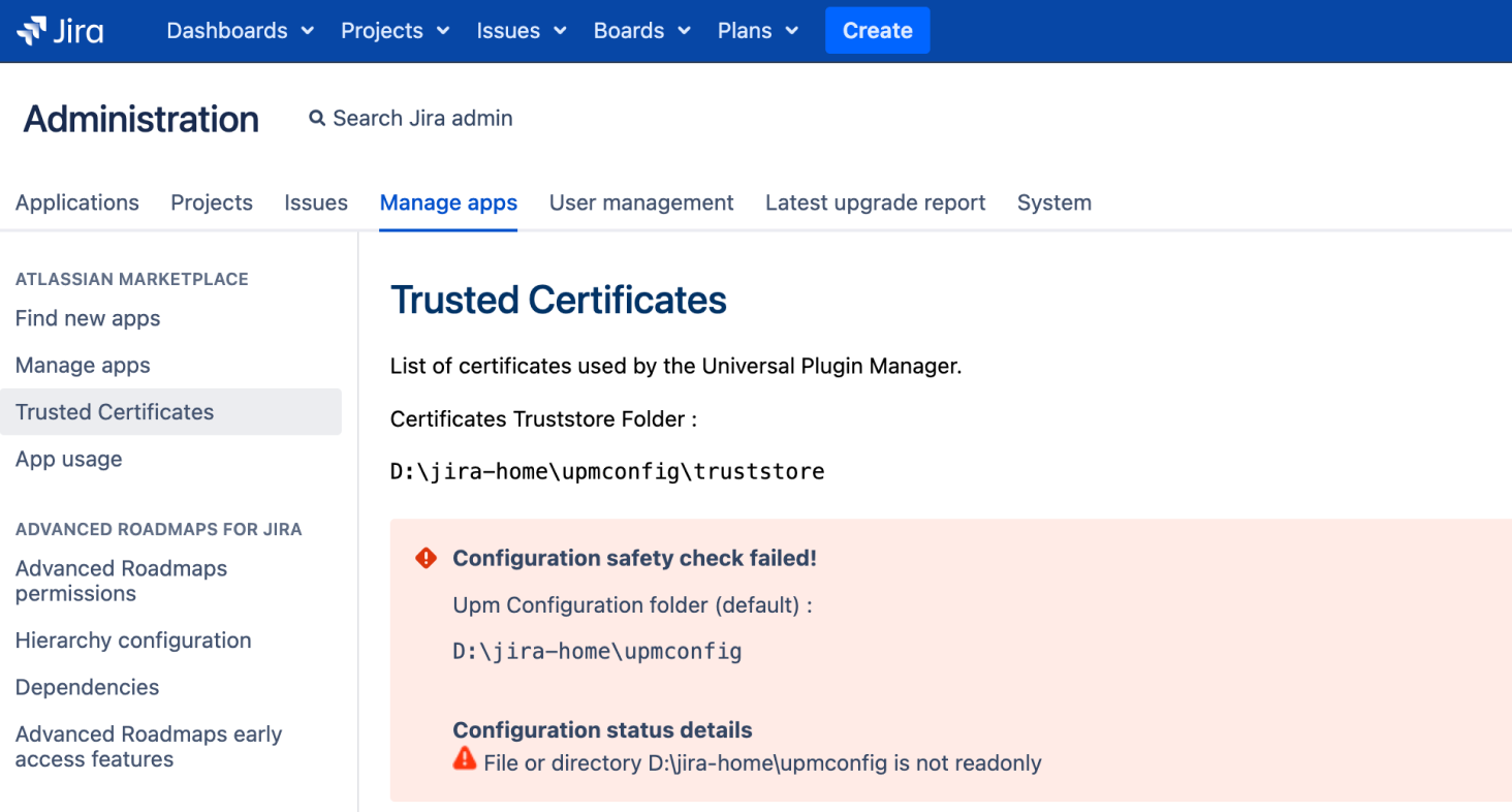

Invalid trust store permissions
Problem: The upmconfig folder has been set up with incorrect permissions.
Error on the Trusted Certificates page
The following are examples of errors you might receive on the Trusted Certificates page under Manage apps:
  • The “File or directory is not read-only” error appears when a file or directory is writable by the user running the application.
  • The “File or directory belongs to the current user” error appears when an element of the configuration folder belongs to the user running the application.

The Trusted Certificates page displays a list of all non-compliant files, each with a mention of the non-compliance.

Depending on the broken rule, two actions can solve this problem:
  • Change the file ownership. If one or more files belong to the user running the Data Center app, you'll need to have filesystem access and privileges to change the ownership of the files to another user, making sure the user running the Data Center app can still read them.
  • Change the file permissions. If one or more files are writable by the user running the Data Center app, you'll need to have file system access and privileges to remove the write privileges of the files from the user running the Data Center app.
For further guidance, check UPM documentation: Configuring UPM app signature check.
