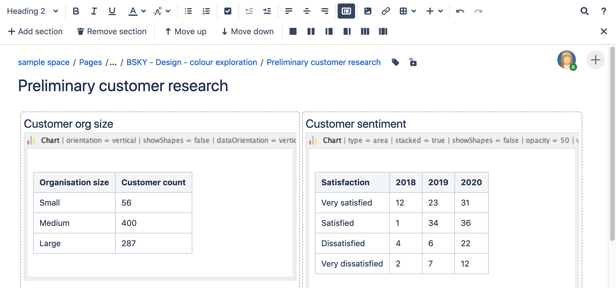

Screenshot: Two Chart macros in the editor, containing the data for a pie chart and stacked chart.

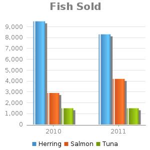

Bar chart
Here's an example of a bar chart.
To create this chart, we set these parameters in the macro browser:
  • Type: bar
  • Chart title: Fish sold
  • Show legend: True
and added this table in the macro body:
Fish Type
2010
2011
Herring
9,500
8,300
Salmon
2,900
4,200
Tuna
1,500
1,500

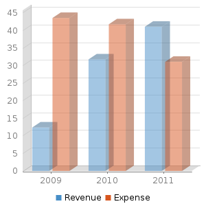

3D Bar chart
Here's an example of a 3D bar chart.
  • Type: bar
  • Show in 3D: true
  • Opacity: 50
  • Show legend: true
2009
2010
2011
Revenue
12.4
31.8
Expense
43.6
41.8

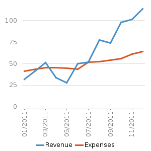

Time series chart
Here's an example of a Time series chart.
  • Type: Time series
  • Date format: MM/yyyy
  • Time period: Month
  • Content orientation: vertical
  • Range axis lower bound: 0
  • Show legend: true
and added these two tables in the macro body:
Month
Revenue
1/2011
31.8
2/2011
41.8
3/2011
51.3
4/2011
33.8
5/2011
27.6
6/2011
49.8
7/2011
51.8
8/2011
77.3
9/2011
73.8
10/2011
97.6
11/2011
101.2
12/2011
113.7
Month
Expenses
1/2011
41.1
2/2011
43.8
3/2011
45.3
4/2011
45.0
5/2011
44.6
6/2011
43.8
7/2011
51.8
8/2011
52.3
9/2011
53.8
10/2011
55.6
11/2011
61.2
12/2011
63.7

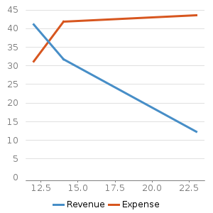

XY Line Chart
Here's an example of a XY Line chart.
  • Type: xyLine
  • Show legend: true
12
14
23
Revenue
41.1
31.8
12.4
Expense
31.1
41.8
43.6

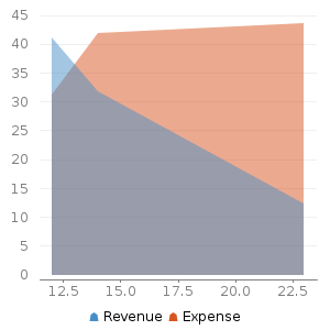

XY Area Chart
Here's an example of an XY Area chart.
  • Type: xyArea
  • Show legend: true
12
14
23
Revenue
41.1
31.8
12.4
Expense
31.1
41.8
43.6

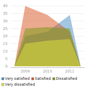

Area chart
Here's an example of an area chart.
  • Type: area
  • Show legend: true
  • Width: 300
  • Height: 300
  • Opacity: 50
Satisfaction
2009
2010
2011
Very satisfied
20
23
34
Satisfied
40
34
23
Dissatisfied
25
26
25
Very dissatisfied
15
17
18

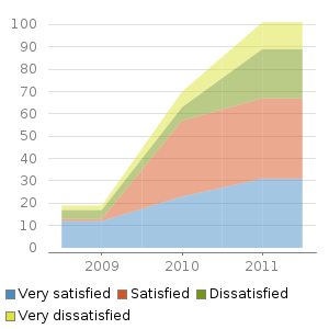

Stacked area chart
Here's another example of an Area chart.
  • Type: area
  • Show legend: true
  • Width: 300
  • Height: 300
  • Stacked values: true
Satisfaction
2009
2010
2011
Very satisfied
12
23
31
Satisfied
1
34
36
Dissatisfied
4
6
22
Very dissatisfied
2
7
12

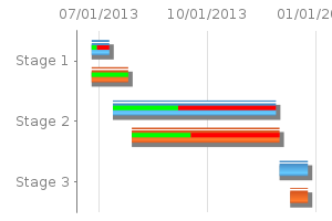

Gantt chart
Here's an example of a Gantt chart.
  • Type: gantt
  • Width: 300
  • Height: 200
  • Columns:  ,,1,2,3,4   (note the two commas to start)
  • Date format: MM/dd/yyyy
PlanStartEndStatus
Stage 1
6/25/2013
7/10/2013
30%
Stage 2
7/13/2013
11/28/2013
40%
Stage 3
12/1/2013
12/25/2013
ActualStartEndStatus
Stage 1
6/25/2013
7/26/2013
100%
Stage 2
7/29/2013
12/01/2013
40%
Stage 3
12/10/2013
12/25/2013
(info) You must include the two leading commas in the column parameter (for example ,,1,2,3,4) for the chart to be created correctly.
